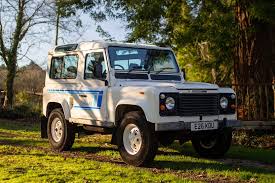

All I can say is, these had no anti roll bar from the factory and where perfectly fine....
So I'd be quite shocked a Jimny wouldn't be ok too. The front suspension of the Jimny is not so different from that of the Defender/RRC/D1, which also offers a degree of natural anti roll and anti squat in its design.

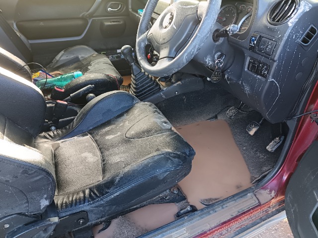

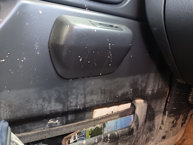

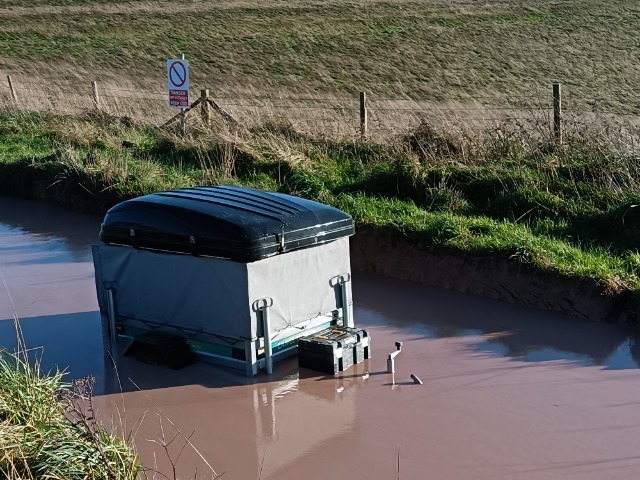

Replied by me101 on topic 2" lift and no ARB
Bought a 2nd hand bar - just going to replace it. Transfer box replacement ordered, gearbox ready for refurb, clutch cable to change and winch to repair / replace. Will check water before entering next time!
