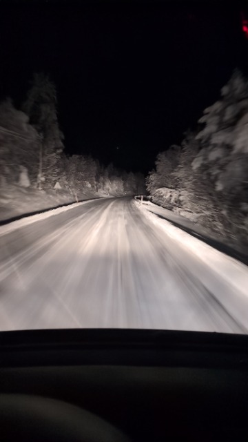

Oh the studded tyres slide too, but more controlable. But most important is the rubber mix and age of them. Old tyres slip and slide much more than fresh. Here winter tyres are old and more or less useless at 5 years studded or not. Most people here in Norway use tyres with no studs now but with a better and softer rubber compound.
