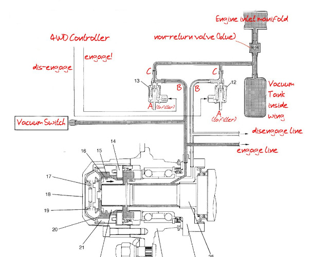

There is a vacuum leak through the solenoid valve that disengages the hubs. (Port B to C in my notation, see diagram)
Either it leaks all the time, and the vacuum tank gradually loses vacuum, which would mean the engine vacuum has to operate the hub directly, or there is a wiring fault (or a piping fault somehow, but I doubt it unless someone has messed around with the solenoid valves.)
With vacuum on the disengage side permanently, there is nothing (literally) to push the hub over to engage, it is atmospheric pressure on the opposite side through the non-energised solenoid valve that moves the hub.
Remember my earlier post?
4) remove the solenoid valves and test them with 12V and blowing through a tube.
There are 3 ports on each,
A) Fresh air (via filter)
B ) vacuum line to hub
C) vacuum line from tank.
Power off:  A connects to B and C is sealed off to maintain vacuum in the tank
Power on:
B connects to C and the tank vacuum applies to the hub to move it (A could be sealed but it doesn't matter, and I never tested it) The other solenoid lets air into the other side of the hub via A-B to push the hub over.
Here is the diagram from the manual, suitably annotated to match my description
This is what the layout looks like
Photograph where the pipes go, pull the solenoids, squirt GT85 (or your favourite magic fluid) into the ports and cycle the solenoid a few dozen times with a suitable 12V supply (be careful of shorts if you are going to use a car battery!)
Then check that
Power off- Port C is sealed A connects to B
Power on- port C connects to B and absolutely not to A as well.
