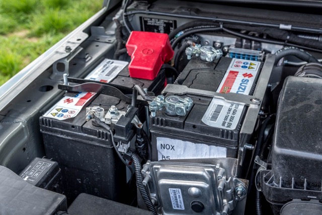

Hi, because of a Warn Axon 55-S installation I am thinking to upgrade my OEM battery to EITHER:
an Odyssey ODX-AGM34R (only 2 cm longer than the 50Ah Red Top Optima but I think its a better battery and is 68 Ah with 850 CCA)
OR
2x Yuasa YBX5053 batteries wired in parallel (giving 100 Ah and 900 CCA but much bigger pain to fabricate the second battery holder right beside the normal battery mount - mine is LHD - there is a custom second battery mount for the OEM-sized battery available out of Germany but it costs a king's ransom!)
I will use a Blue Sea M-series 4 position disconnect switch which is rated 300A constant mounted beside the battery positive terminal and this will give me the opportunity to run the winch and DC-DC charger to power bank either together, separately or both disconnected when not carrying a power bank, with the winch normally disconnected. The option of both is so that I can reverse charge the battery from the power bank as and when winching to assist the OEM alternator.Back to the alternator itself. In my use case would you recommend also upgrading the OEM alternator? I intend to draw around 45A max with the DC-DC charging by manually lowering the charging maximum wattage, so no more than 50% of the OEM alternator's output, but the Ecoflow alternator DC-DC charger can go up to 800W. If upgrading, what would you recommend easiest and best to fit without requiring a lot of modification?
I would appreciate your thoughts on this! Thanks very much!
OR

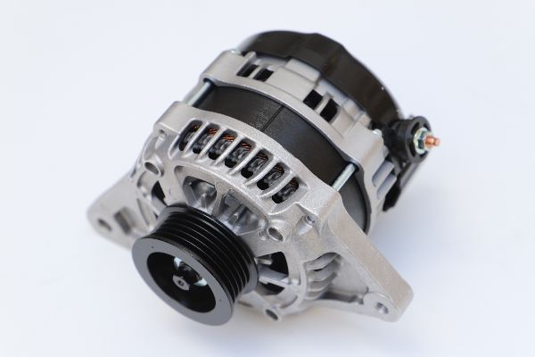

Hi, yes I'm thinking to leave the OEM alternator and just upgrade the battery. No worries for the Ecoflow DC-DC charger. Although it can charge up to 800W, the maximum can be set by the user. So I plan on setting it to draw no more than 50% of what the OEM generator is actually putting out, looking at both idle and say 3-3.5k RPM. This probably means setting no more than a 40A maximum for the DC-DC charger draw. If I ever upgrade the alternator it can be changed. I have been advised an alternator from Japan that can just be swapped out and gives 120A but it costs around $870 or $570 with exchange of working OEM alternator...
easycars.jp/product/motorage-sc-type-hig...ator-for-jimny-jb74/

Check the Denso 31400-61MO it is 100A and may fit. I am planning on buying one from a scrapper to see if it fits my gen3, may fit the gen 4 too. Most euro car parts web shops have a detailed drawing of both so you can see if it is close enough.
For my Gen3 I will need to fiddle with the connections but the physical measurements looks OK. For me 100A generator would suffice.
