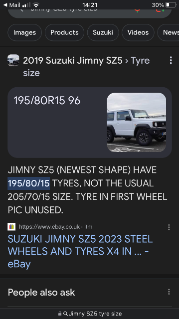

25 Jan 2024 14:23 - 25 Jan 2024 14:30 #253741
by lightning
Replied by lightning on topic Yokohama Geolandar
Last edit: 25 Jan 2024 14:30 by lightning.

25 Jan 2024 17:43 - 25 Jan 2024 17:45 #253747
by rogerzilla
Replied by rogerzilla on topic Yokohama Geolandar
There is quite a big difference in rolling diameter. The speedo will over-read even worse than normal and revs will be much higher for actual road speeds.
Blackcircles have the G015 in 195/70R15.
