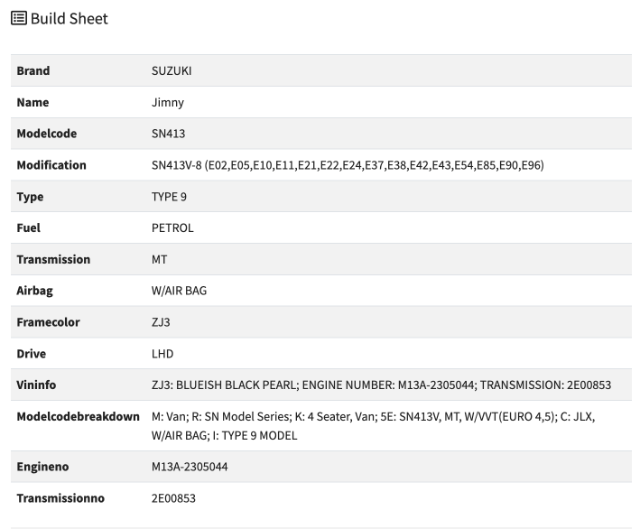

Hello! I have a 2013 Jimny 1.3 JB43.It's the JLX model. According to the technical sheet I found online, it should have Airbags and ABS as safety features, but my Jimny doesn't have them. However, it does have other things like central locking and electric windows. I'm not sure if this is due to it being a more basic version or because of the year. What I found curious is that when I looked up my vehicle's VIN on the following website
www.vindecoderz.com/EN/Suzuki
, it indicates:
Among all these characteristics, some match, like the color and engine type, but others don't, such as the model (Samurai?), fuel type, and airbag, etc.
Why are there inconsistencies? Is this normal on this web pages?
Returning to the topic of Airbags and ABS, I checked, and it doesn't have them. Is it possible to add ABS?
Best Regards!
Best Regards!

You are calling it a jlx which suggests you are not in the UK? Easiest way to find out what it has is to look. Does the steering wheel have a large centre horn pad with the letters SRS on it? Under the bonnet on your right hand side above the inner wing is there a silver metal cube with many metal pipes going into and out of it. If you have then that's the air bag and the abs pump respectively.

I'm also guessing it's a non-Europe model, as ABS was mandatory in the EU from 2004.
