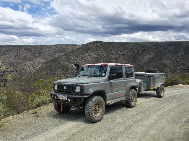

I have 235/75R15's running on the stock steel rims (no spacers). I only put them on after I lifted by 50mm. With the stock bumpers I needed to do a bit of trimming to the front, but they still caught while turning in reverse. However that was after I had already run the front bumper into the ground and bent the lower mounts, so don't really know how much trimming is really required.
I have after market bumpers now, so no issues rubbing on the bumpers. I have noticed some minor rubbing on the top of the front wheel arch lining. No rubbing on radius arms or anywhere else. Rears are fine, no rubbing anywhere.

I can confirm the front bumper mounts bend easily. I dropped the front wheel into a hole at the BigJimny event, everything seemed fine, but the near side front wheel caught the bumper at certain angles especially in reverse. I run 215s and no lift.
I drove home 300 miles without noticing it and it was only reversing in to a car park space a few days later that I heard it. Fortunately the lower metal mounts are thin and easy to straighten, I didn’t even need to take the bumper off.

Thanks for the info. I have an aftermarket bumper that has some adjustment in it. So I think I should be fine there. As long as they don't rub the rear arches or bumper that should be fine.I have 235/75R15's running on the stock steel rims (no spacers). I only put them on after I lifted by 50mm. With the stock bumpers I needed to do a bit of trimming to the front, but they still caught while turning in reverse. However that was after I had already run the front bumper into the ground and bent the lower mounts, so don't really know how much trimming is really required.

I have both front and rear steel bumpers. They were prototypes made by a local South African company Des-Sol - the production versions look somewhat different.
