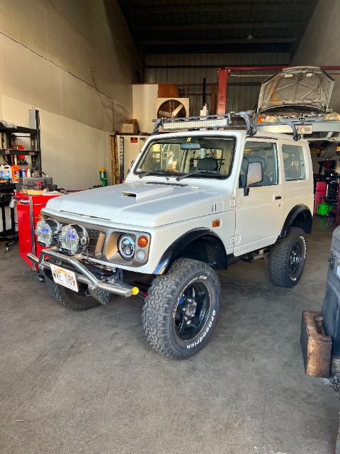

This has a G10T engine. Three-cylinder EFI Turbo no vacuum advance.
Looking for suggestions on what could cause what feels like a misfire that starts at 3500 rpms. It feels like the ignition is turned off and immediately right back on again and again. It must be half throttle all the way to full throttle. I have replaced the distributor complete, cap, wires, spark plugs, and coil. I have checked the fuel pressure, 35 psi, and under boost, 55 psi. I checked the fuel volume. I have checked for codes, but no codes. I can’t find a crankshaft or cam sensor. Any help or suggestions would be great. Thank you.

What Jimny is this?
Distributor and boost suggest it's different than the majority on here.
If it actually has a distributor try fitting a wire between the plate on which the (points?) are mounted and the bottom plate. The bottom plate is fixed (and earthed), the top plate sides with the vacuum advance. You can get intermittent earth connection between the two plates with age, a flexible bridging wire cures this. This is just a generic "classic car" fix for similar symptoms and may, or may not be applicable in this situation. But worth a mention just in case, I'll now shut up as I only know classics or my M13A

This is a customers vehicle. I have no technical information on it. I don't even think the year is correct. It is my understanding that the Jimny is not legal in the U.S. I am looking for the crank or cam sensor and can't find either. I appreciate your reply.
