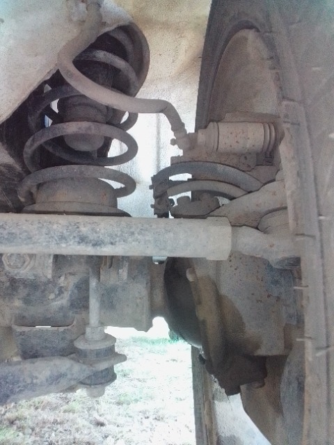

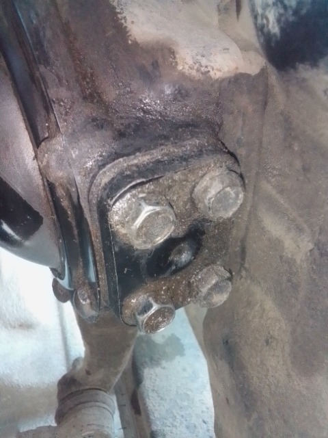

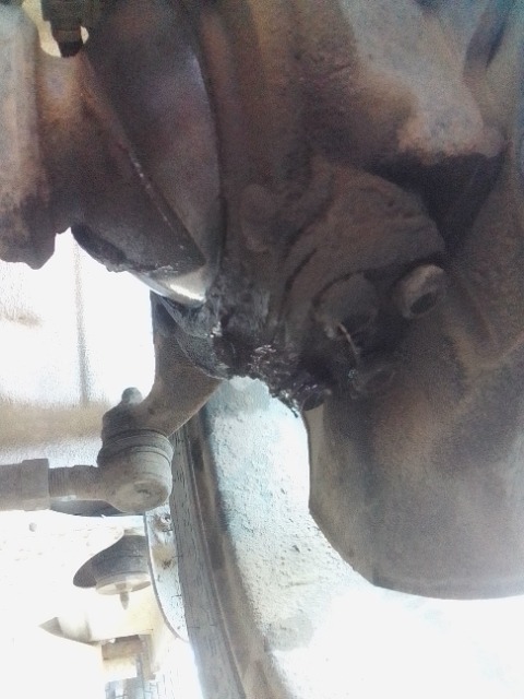

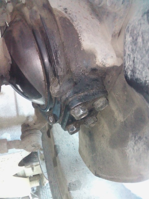

Hi All,
I'm trying to keep my old 2007 Jimny (from Japan) alive here on a small island where I live. I don't know much about cars but have been able to do little fixes like patch up the radiator with high temp epoxy, minimize rust with rust converter and lube locks and hinges with WD40, but I NEED YOUR HELP and advice please. This week, I spotted an 'oily oozing' coming from an area just behind my front left tire. I'm worried it could be the sign of something serious. Could you Jimny Xperts please look at these photos and advise me what I'm looking at in these photos and IF I need to worry about this stuff that seems to be oozing out of this area behind the left front tire. See photos please.

That is most likely a leaking half shaft seal. This is generally caused by worn swivel bearings. It's a simple if messy repair job. If you do a search on YouTube for suzuki jimny swivel repair you should find a number of videos showing the process.
If you don't feel up to the job any garage can do it.
It's not an urgent problem but you do need to fix it at some point.

Nothing drastic will happen but the main parts you need should be easy to find. The bearings you need are 30302 taper rollers. They are a common bearing used in many applications, so if there is any sort of industry on your island you should be able to find them. The seal can also be replaced with an off the shelf part. Its a rotary shaft seal, size 26x38x8.
The oil coming out is from the front differential. The differential is only moving when you're in 4wd, so in many instances they can go for years with no oil without causing problems. However if you use 4wd regularly then keep an eye on the differential oil level. But keep in mind they can leak for a long time before it get's low enough to cause an issue.
