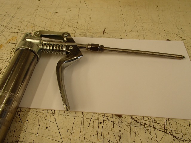

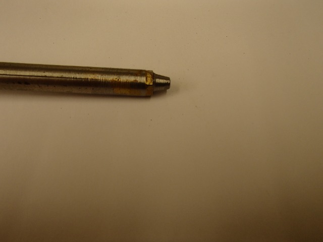

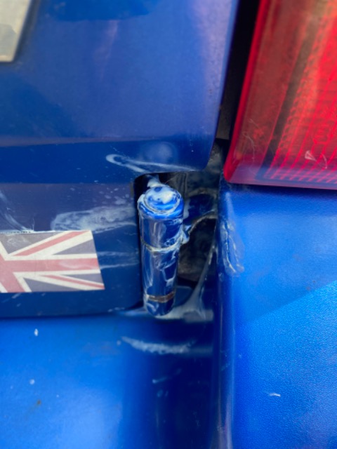

21 Jun 2023 15:50 #249578
by Roger Fairclough
Replied by Roger Fairclough on topic back door getting stiff to open and close
On the Gen.4 the rear hinges have a drilled hole at the half way point. I modified a grease nipple to put a point on it and brazed it into a grease gun extension tube. It doesn't take a lot of pressure and it will pump the grease of your choice to all the points necessary. I have enclosed a couple of pics. to show the details.
Roger
Roger
- Posts: 2344
- Thank you received: 676
21 Jun 2023 19:25 #249585
Replied by DrRobin on topic back door getting stiff to open and close
Thanks Roger. My Gen3 doesn’t appear to have a notch and no matter how much spraying I did in the middle of the hinge made the slightest difference. However a quick spray on the top fixed it.
I originally thought it would be stuck at the mid point, but now I think about it, it is the top which is open to the rain.
I might find some rubber covers for the top of the hinge.
Robin
Robin
