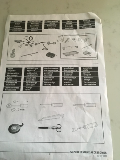

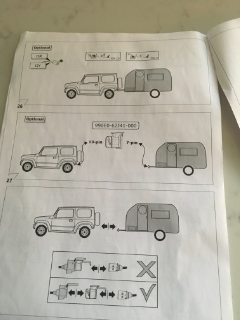

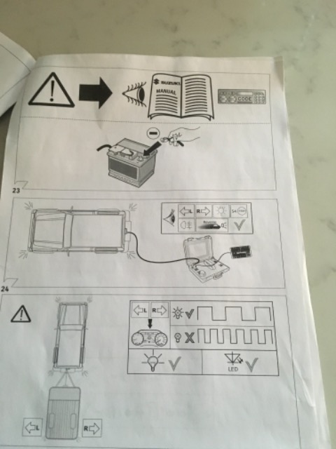

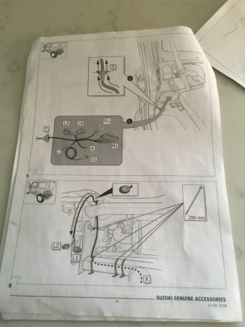

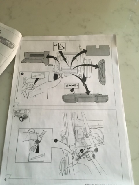

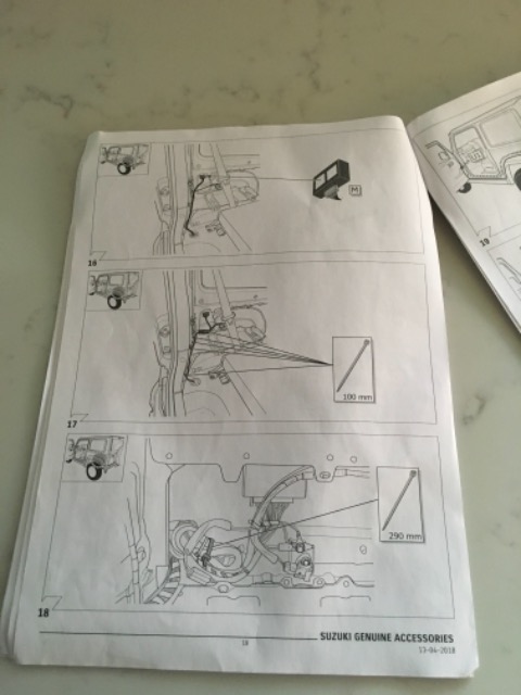

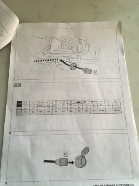

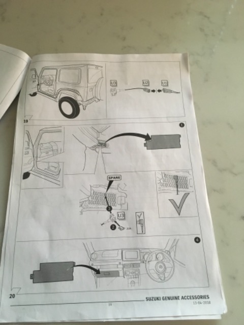

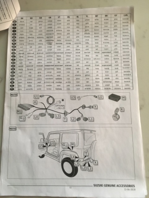

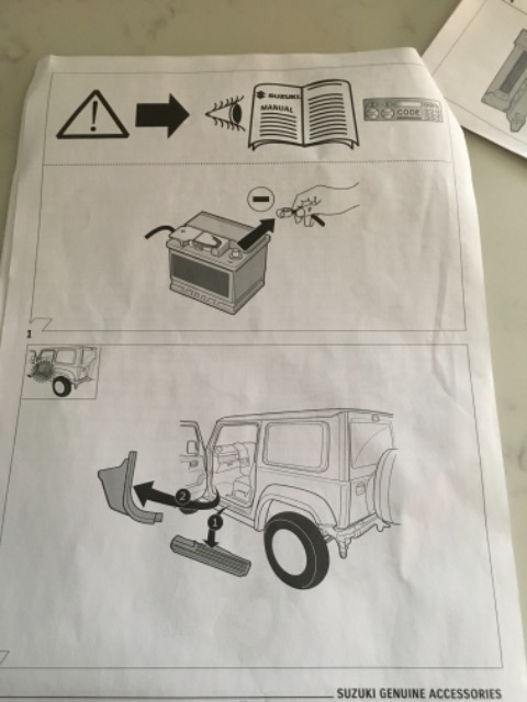

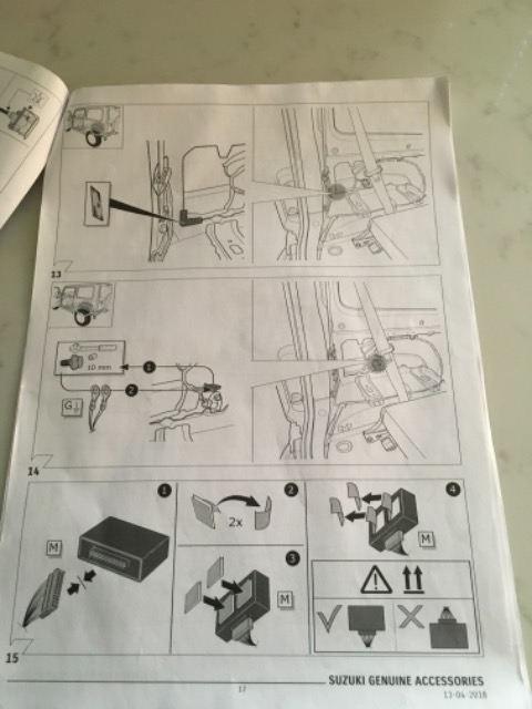

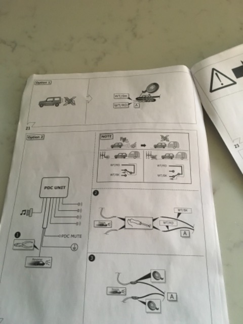

Can anyone help with the wiring diagram for my 2020 jimny i need to install tow bar electrics

Here you go..
will do it as two posts.
