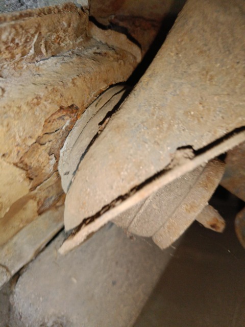

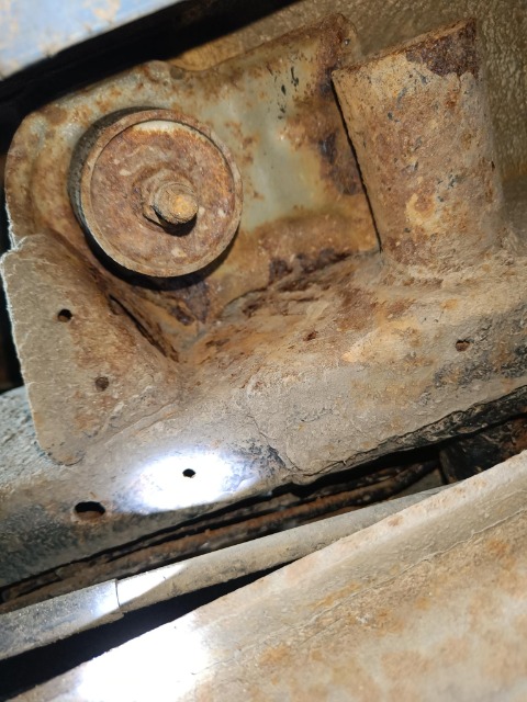

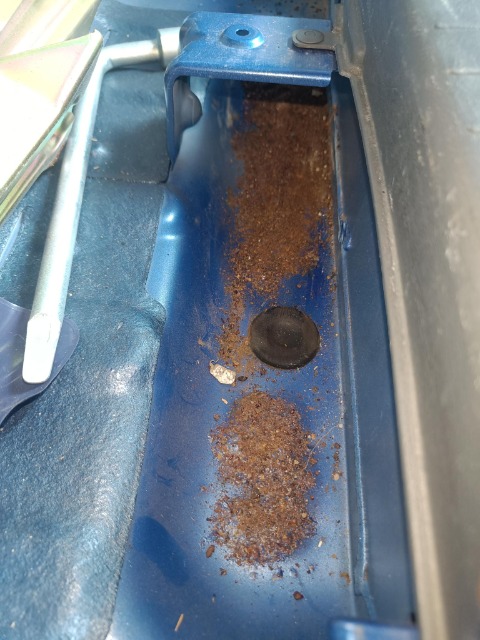

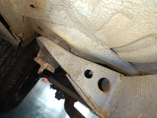

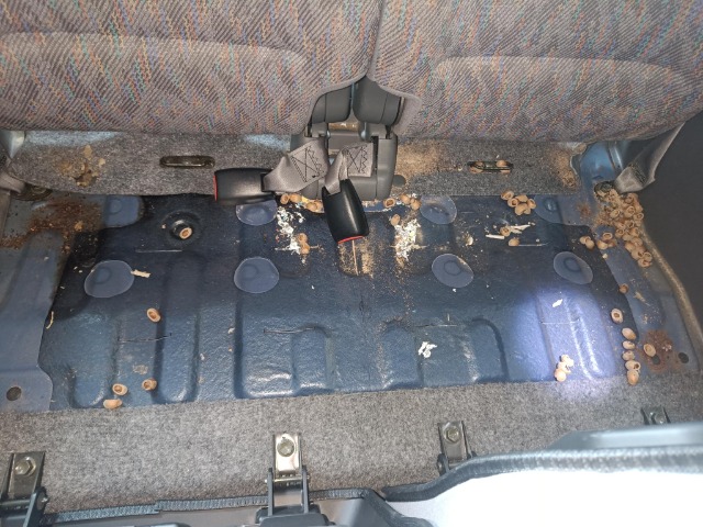

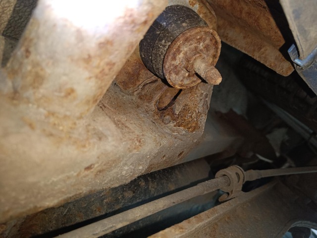

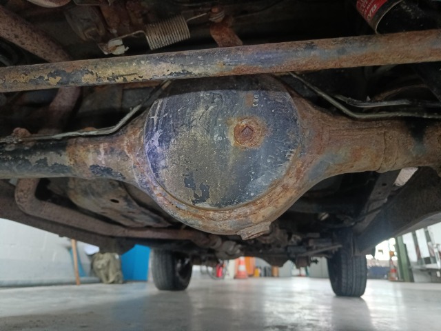

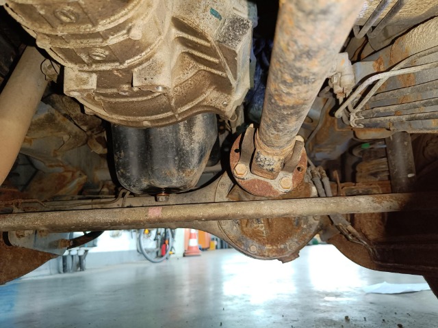

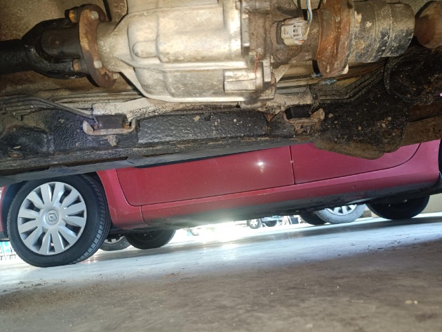

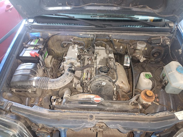

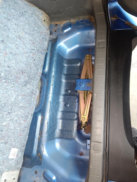

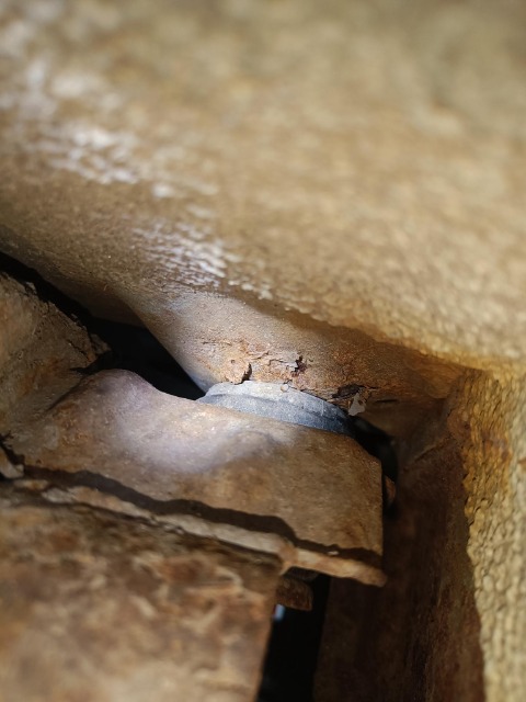

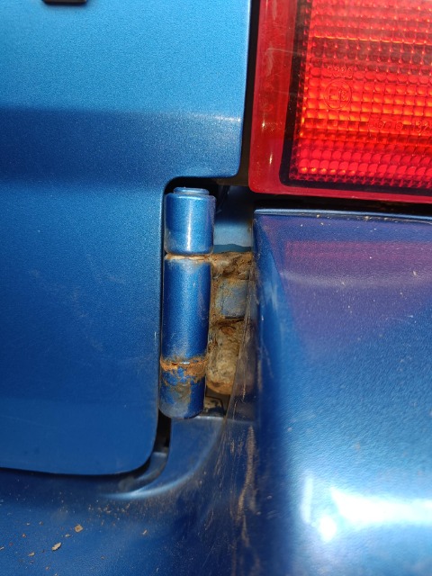

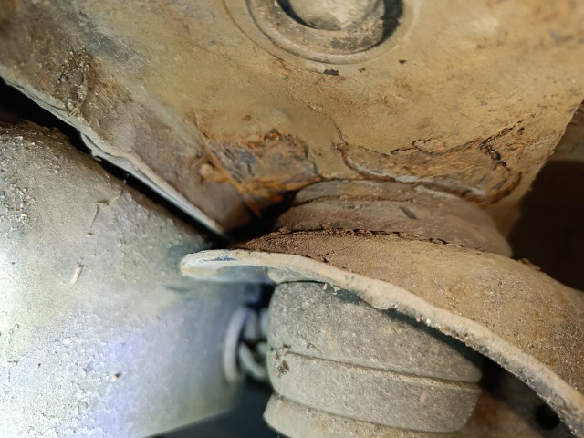

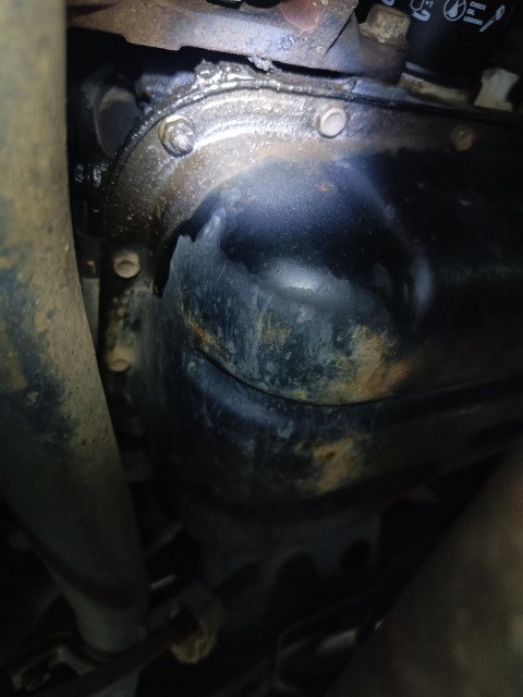

Ok well I went to view the car today, was able to take as long as I needed to look through it all and test drive. Will upload pics following this post but to start:
General points:
- The engine is a GB13B (had my suspicions when i read it has 82ps in the ad)
- VIN number begins with JS
Good points:
- No engines noises, no engine smoke, temp gauge planted to middle, fluids at right level and looking good, transition very smooth, 4wd ranges engaged without any issues
- General condition of the car seemed very good
- Everything looks original, no tampering, all bodywork lined up as it should, no evidence of any respraying. A few minor scratches otherwise for its age the bodywork was in great nick.
- The interior also looked very good, all the plastics etc nearly mint condition.
- All lighting, cockpit controls including functionality all worked seamlessly
- All sills & windows in good condition
- Absolutely no death wobble, only started to feel some modest steering wheel shake at around 110km but i think that is normal
- Felt very true on the road, did not pull to one side or another, good under breaking
- All brake line and vacuum system looked in good condition
Bad points:
- Some rust apparent beneath the car at at various points but I was hoping to see what you guys thought how severe it looks. To me it seems quite superficial and not structural, there were a few areas where i could peal the bottom layer of material off but solid beneath (see various pics). Perhaps one body mount looked a little concerning otherwise there was nearly no rust behind front lights, along side trim etc. It looks like some of the underside of the car was undersealed before but does't look like the most thorough job
- Small area at underside of engine block where there seems to have been/is some oil or fluid escaping (very contained - see pic)
- Some mice managed to get in the car while it was stored in the garage and seemingly made themselves at home under the back seats, fortunately didn't chew any material up but smells like a bloody hamsters cage.
- Tyres have plenty tread but manufactured in 2007
- Sliding mechanism on driver seat is on its way out
- Light squeaking on brakes
- Corrosion on Wheel alloys

16 May 2023 19:44 #249145
by kenndo
Replied by kenndo on topic Buying my first Jimny
Any thoughts on the pics and general condition welcome particularly regarding the rust and also leak on the engine block.
