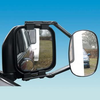

Want to try the caravan behind the Jimny. But my extended mirrors don't seem to suit the Jimny mirrors.
I have a set of these that work well on my p38 RR:
But there isn't really enough gap around the glass to fit them on the Jimny.
I can't see any 'official' extended mirrors from Suzuki. So looking for suggestions on what will work.

I've tried these - absolutely useless - avoid. Vibrate way too much and iffy fit at best.

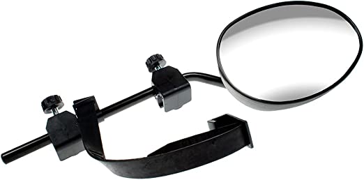

I've now use MP8327 and the "tongs" just clear the glass at my adjustment. If I move the Jimny mirror glass slightly they clear well. I can't remember at the moment if I mount them on the Jimny mirror bottom, rather than the top as shown in instructional pictures. It does not matter which way you mount. They work very well for me, but is a G3.
A lot cheaper than the similar Milenco, which when tried did not clear the glass on mine also.
Hope this helps some way.
