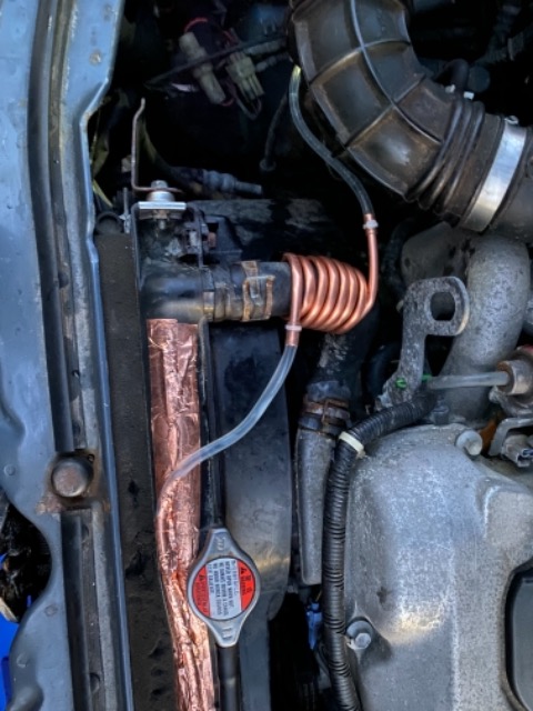

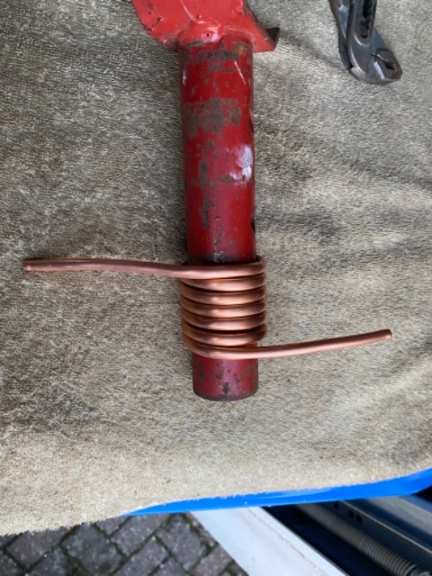

28 Jan 2023 19:27 #247240
Replied by DrRobin on topic Cold weather preparedness.
I tried wrapping a flexible washer tube round the radiator pipe and it seems to work fine so bought a small length of copper pipe and wrapped this round the pipe, seems to work great, now all we need is some -5C temperature again.
Robin
winding the copper tube on a former (axle stand)
In place and connected to the flexible pipe.
Robin
