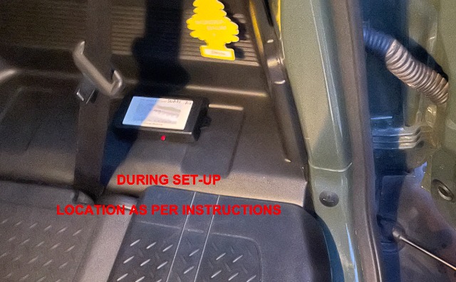

Hello all,
I have received the Iron Gates device from spooftpms.com/ , had a bit of trouble with the written instructions, but Mr. Popa rescued me with the instructions below:
Quote
You do have the TPMS error on the dashboard, yes ? in this case:
- mount device like in photo; keep it turned off
- drive towards a road section that is straight and without obstacles
- turn device on, set to "learn mode" as on the diagram
- start driving at constant x kmph; x depends on wheel size. What is yours ? (eg. 25/35/R45)
- once the error has cleared put the device back in "normal mode" - power off/power on always puts it in normal mode.
Unquote.
For my tyres' size (215/75 R15) the ideal set-up speed is 53km/h.
In about 2km the screen was back to white, no more issues.

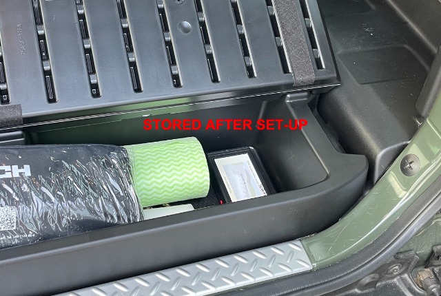

I then removed the device from just above the rear right wheel and stored it, firmly attached with 3M double tape, to the storage box.
Perfect!
