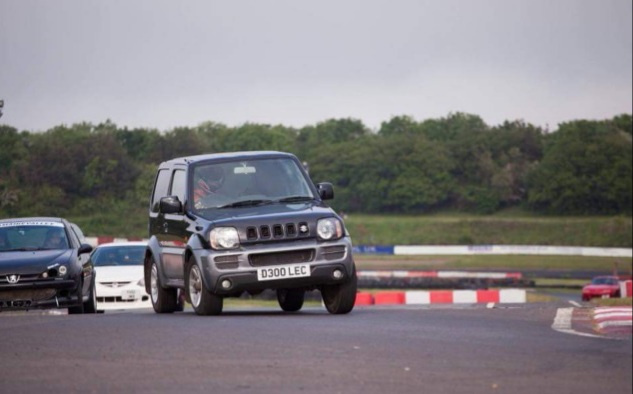

This is my last Jimny with lower suspension trying quite hard on a track, certainly more so than any responsible person would on road and it's not sliding.
