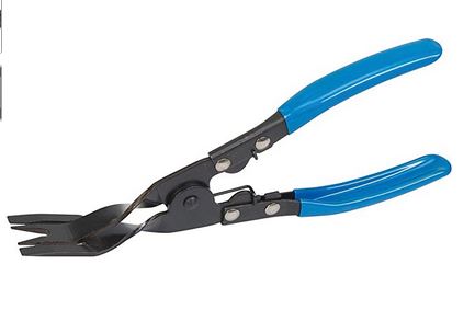

I would get a set of these
www.amazon.co.uk/Silverline-927687-Trim-...Pliers/dp/B005DQ7ZEU
It makes the job easy.
