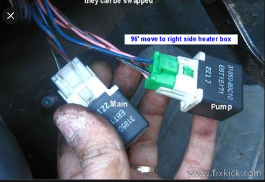

The Jimny is a 2009 year one of the jb43 models I replaced fuel pump with a new one only to find that the new pump isn’t being powered up but both the old and the new fuel pump works perfect when tested on a 12v battery

Greakking check the relay by swapping them with each other and 9 times out of 10 it's a €5 replacement relay.

I did swap the relays but the issue still continues. What else can possible cause this issue.
