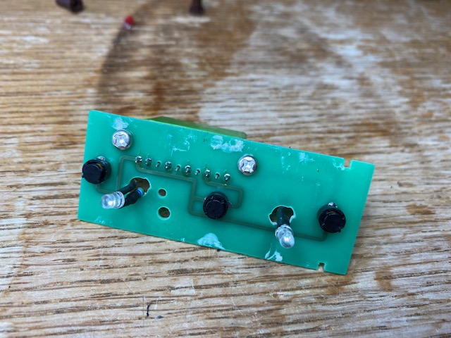

21 Mar 2022 12:37 #242429
Replied by DrRobin on topic 4x4 does its own engagement
This is the PCB inside the 4x4 selector switch unit. This is my new one with LEDs in place of fillament lamps.
Robin
Robin
