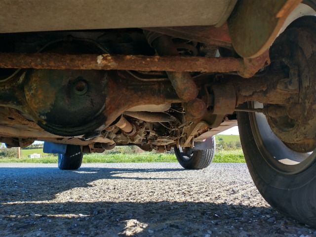

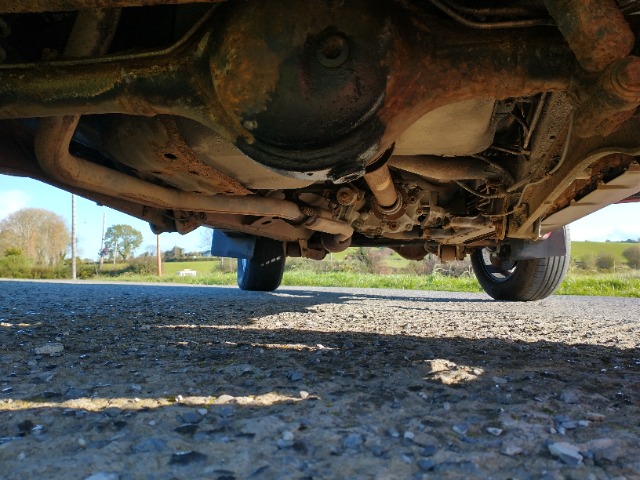

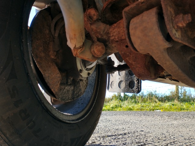

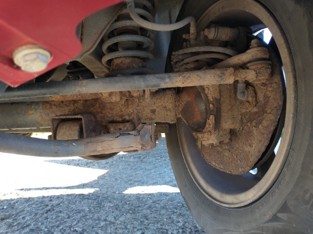

I've been hunting for quite a while, probably years, for a good soft top Jimny. One has come up fairly locally to me and I was excited to take the morning off work to drive down to see it and take it on a test drive. The interior, roof and bodywork all seem grand but underneath there is a fair bit of rust and I would appreciate thoughts and opinions from those who are experienced in Jimny care and restoration.
it's a 2006 model with 92k on the clock, 6 months mot remaining which makes me think that the rust can't be that bad if it passed mot half a year ago. There are leaks from the centre of the back axle as photographed and also a leak from brakes or suspension at one corner. I'd appreciate any thoughts on the problem and cost of repair and of course any other useful info overall on what to look for.

The problem areas and the ones that are expensive to put right is the chassis-body mounts, the boot floor and behind the headlights amongst others. It does look like a lot of surface rust on the photos there but can't see the problematic areas.
Just remember dodgy MOTs are a thing and sometimes Stevie wonder is the MOT tester.

When I bought my 2011 I looked underneath and it had some surface rust, but not as bad as this one. All of the bits in the photo that are rusty would be easy to change , but as Pdoge says the problem areas are not visible.
I would check the MOT history, see if it passed first time and if there were any advisories at the following www.gov.uk/check-mot-history if it is a UK registered car.
I suspect you are going to have to do some work on this, if not now, but in the future so it all comes down to how much is the asking price, if you will be doing the work yourself and how much will be done in a local garage.

It has a lot of surface rust, probably typical of a none waxoyled Jimny of the age, but unfortunately that's all we can tell from your photos.
AS said above the key rot areas are as follows:
Front body mounts
These are below the headlamp, behind the plastic front wheel arch liners and almost impossible to see. That said if you can see rust behind the headlamps / inner arch it's likely they have rotted. Pain to fix but then the MOT man can easily see your fix
"A" pillar body mounts
Just behind each front wheel, above the chassis, outrigger, easy to see and have a feel for rot. Probably the hard one to repair.
REar body mounts.
Just behind each rear wheel.Again easy to see. Running a close second for awkward repair.
Rear floor just above exhaust silencer.
Look from inside the vehicle, the same recessed area that hold the jack. If you can see rust inside it's probably on the way out. Easy fix if not too rotton.
Sills
CHeck the inner will under the vehicle, just after the A pillar mount. They tend to rot here.
Not an exhaustive list, but the top rot spots in no particular order. It's worth checking as it is very random, some cars do, some cars don't. Statistics would suggest that at 2006 at least one of the above will have started. My money is on the front body mounts and rear floor.
The chassis is usually good, but still worth a look just above the rear radius arm mounts.
Don't worry about the oil behind the front wheel, it's a sign the kingpin bearings have failed (in the past) or are failing. If it's something that needs fixing it's about £50 in parts and 2 hours of your time, not difficult to fix.
Hope it's a good one, and nothing is too difficult to repair if you have a welder.
