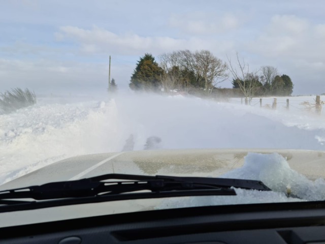

Axholme - I sympathise with your question and it sounds to me that you do indeed know how to use the 4x4 system hence your questions rather than sticking it in 4x4 at 1st sign of poor traction and ending up with transmission lock. I have been thinking about this over the last weekend as in the NE of scotland we have had quite a lot of snow over the last week. About 7 to 8 inches level snow around about where I stay. On Friday night the wind got up and started blowing the lying snow. So what I experienced on Saturday morning was side roads completley white with lots of snow and lots of drifts so 4H engaged. However on the main roads it was black tarmac apart where the snow was blowing over the road. So I was constantly changing from 2H to 4H as I enountered the snow. Was I too cautious could I have carried on in 4H for longer maybe? I like you are paranoid amount transmission windup. So quite often left it in 2H and only when came across significant areas of all white did I engage 4H. Now I have Toya Opencountry + AT tyres and they coped very well. Not as good as winter tyres. So I would very much consider 300BHP ideas of winter tyres all year round. Gives you the grip when you really need it in the winter and summer performance is still good. It's not as if we are speaking about a high performance sports car.
Roger refers to 4H being a must for icy roads which is different to my driving. Or at least depends on definiton of icy. Black roads at minus temps could be icy and could be slippy so having AWD would be preferable however giving those circumtances I am not going to engage 4WD in the Jimny.
Had a great time over the weekend delivering essential shopping and ploughing through drifts and traveling up farm roads impassable to most. Jimny very capable in the snow.

You've hit the nail on the head. It's the times when roads are icey but not covered in any form of white stuff. It's good to get other peoples opinions who are driving the same vehicle. Looks like good fun up there. our other car is a Subaru XV which is a cracking all weather motor suitable for all conditions, but i do love the Jimny. I had a gen 3 before and was really sad to see it go despite all it's faults. there's just something about them i like.
