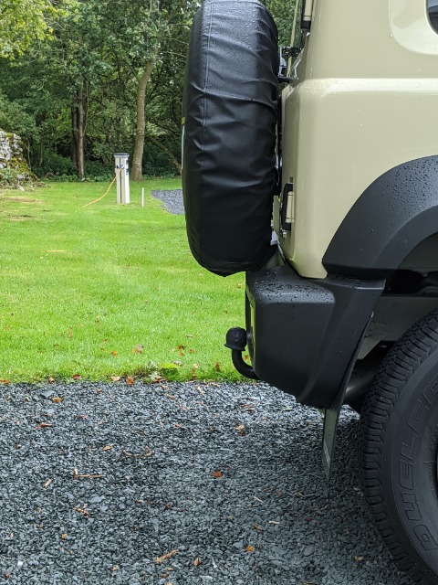

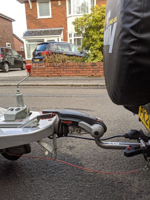

From my experience I would advise you use the Suzuki towbar and the Suzuki harness. I took my GEN4 to a towbar specialist, however they hadn't fitted one before so they used their usual supplier which was Brink, he advised me to use the correct harness because the car was new and a generic one could invalidate warranty.
Anyhows as it turned out the after market towbar was too short and I could not fit my ALKO hitch without taking my spare wheel off as the ball was under the tyre, the Suzuki one is specifically made to clear the spare tyre. They had to order me a Suzuki one and change it out as the Brink "wasn't fit for purpose".
you can see the difference with the two pictures, below is the Brink and below that is the Suzuki.
