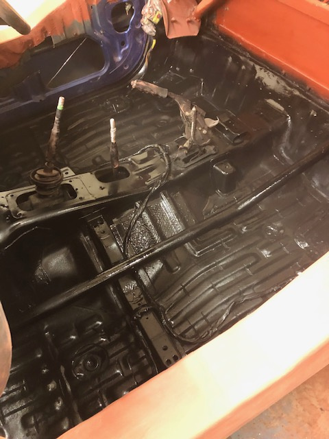

08 Jan 2021 10:41 #231605
Bed-liner!
The first thing I do when I start any Suzuki project is rip the carpets out and throw them away! :laugh:
Replied by X8GGY on topic Wet, soggy smelly interior's..!
Or...Roger Fairclough wrote: Ultimate solution is to remove the carpets and leave the floor bare or cover with rubber or plastic matting.
Roger
Bed-liner!
