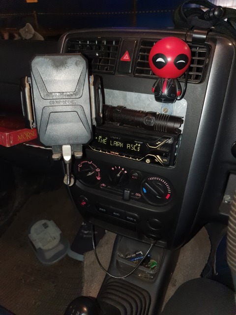

Hi Lambert!
Thank you for the photo! That definitely does the job! I need to have a look into all scenarios before picking which one.
thanks again.
