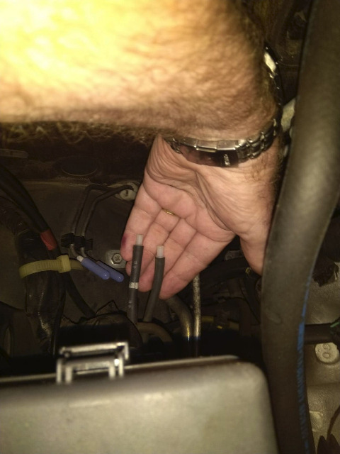

25 Nov 2020 22:27 #230403
by zukebob
Replied by zukebob on topic Automatic Jimny Manual Hubs
My experience is that the flashing 4WD light indicates a fault and 4WD will not engage. As long as the vacuum system is properly plugged so that a vacuum can be established, the controller should allow 4WD engagement. Probably the best place to plug is as close to the vacuum switching valves as you can.
This is a picture of mine:
01 Dec 2020 03:32 #230540
by Joely978
Replied by Joely978 on topic Automatic Jimny Manual Hubs
- Posts: 764
- Thank you received: 227
01 Dec 2020 05:02 #230541
by zukebob
Any leaks in the system below the two metal tubes you plugged wouldn't have any impact. That entire portion of the vacuum system, starting where you disconnected from the metal tubes and going to the hubs, could actually be removed. Most people don't remove it simply due to the effort involved or because they may want to return to the vacuum hubs in the future.
As long as you only disconnected and plugged the 2 hoses connected to the tubes (the metal tubes leading down to the hubs), you should be good. If you do have a leak causing your problem, I would suggest checking the line that leads to the vacuum tank under the right fender. If that is in good shape, check the lines and plastic tees around the vacuum valves. At the same time, make sure that there aren't any other vacuum hoses disconnected.
