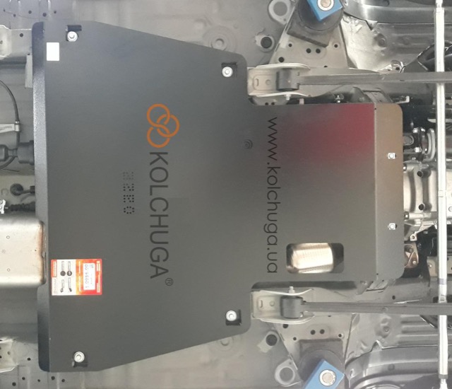

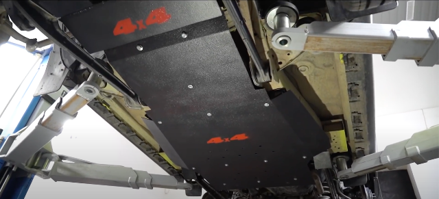

When it comes to protection for the lower side of the car the options range from Suzuki's own differential guards (the minimalist option of all out there perhaps) to custom protection that covers entire surface of the underbody with something between the two extremes.
The full underside protection is tempting but I heard a few seemingly valid arguments against it. E.g. it's going to be just too heavy (add about 40-45 kg). It will collect all of the dirt and ruin proper air circulation which will prevent the needed cooling for all the important stuff that's underneath the pretty bodywork. It will also get even heavier as it continues to accumulate mud and stones. Cleaning the underbody is going to be very difficult too.
On the other hand, it protects everything that's exposed down there.
The Suzuki's differential guards seem too little of protection. I thought maybe combining the Suzuki's differential guards with an engine sump guard would be the most balanced and optimal protection for my needs?
I can't really decide what to go for. I could use some advice.

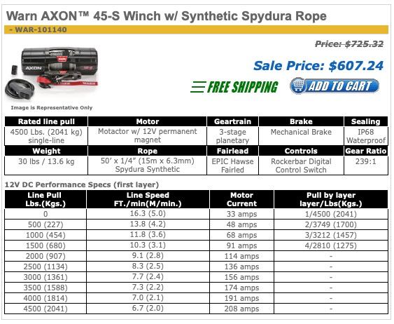

As for the winch, I'm looking at Warn AXON 45-S which weighs about 13.6 kg and with all the mounting brackets it'll probably reach at least 15 kg easily.
With an air compressor and the winch installed in the front (stock) bumper wouldn't be I putting too much weight on the front of the car?
Overall, is there a rule of thumb for how much additional weight I can put on the car by attaching all these accessories?

I don't personally have a winch (due to weight) but I also don't go on trails alone.

Probably the only protection I'd consider essential are radius arm mount guards, as they always seem to get damaged first. If the photos you posted are indicative of the trails you're driving, I don't think you need any of the other protection or a winch.

The maximum load that the car is allowed to carry is, iirc 340kg-ish, including passengers, so slapping 100kg of armour and winch on the car isnt something I'd choose to do.

The Suzuki guards are pricey. Check out Jimnybits for much cheaper and likely better options:
www.jimnybits.com/jimny-18-on/guards-protection.html
Some of the underbody guards you listed look way over the top. I'm not really sure what use they would be. The sump is unlikely to be a risk for most off roading, due to where it is located in the vehicle.
From experience I would say the transfer box is vulnerable and the radius arm brackets. The rock sliders/side sill bars are a very good idea too, but make sure you get some that fit well and are strong. I've seen some YouTube vids of them wobbling about and not doing much.
Diff guards, really depends on the terrain. If you are likely to be hitting the diffs against rocks, then yes. If not, you probably don't need them.

If you are going as only one vehicle. Then something like a winch would be sensible. And maybe some waffle boards.
