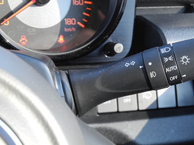

For me to have only the Daylight Running Lights "ON" I have the engine running and my switches set as below:
The Owners Manual, on Page 2-56, gives all the switch combinations required for any other, Night-time and Position Lights.
I think you may be confusing the DRLs with the Front Position Lights: See Page 6-48, #2 Front LED Position Light.
Edit: By using this switch position in the photo, this is the only way I can get the 'Day-time Dashboard Lights' to work as they are controlled by the dash-top sensor. In any other Switch positions, it reverts back to the 'Night-time Dashboard Lights', there you can use the little bar menu in the middle screen.

As GeorgeC says, Day Running Lights (DRL) are not controlled by switches or humans. They are an EU (and other areas) legal requirement and come on when the engine is running and the main lights are off.
For the EU we have headlights with integrated "side marker" lights, these are controlled by the switches on the steering wheel. We have fog lights in the lower bumper with a fog light bulb (again controlled by the steering wheel switch) and a DRL bulb (controlled by the vehicle electronics)
I know some markets do not have the DRLs in the fog lamp housing and do not have the mounting point to fit them.
You can check if you have them by turning all lights off on the steering wheel switches and starting the engine, they will then light up.
