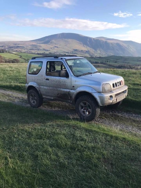

I'm on 215's with only 45mm of suspension lift. No trimming required, no catching, no problem off road. Speedo now perfectly accurate. Slightly slower acceleration, slightly better motorway cruising.
I had much similar concerns to yourself when I first got my car. Tarmac manners were a big concern as I knew it would spend most of its time driving on road, not off road. A body lift raises the centre of gravity so was out of the picture for me.
I have 30mm spacers and standard jlx alloys, given pretty frequent off roading and foolishly wading without breathers..... I am on my second set of front bearings in 2 years. Not bad considering my mistake and how it is used.

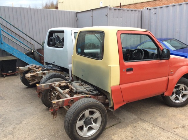

I don't know what is gained off road, going to 215's from 205's as I never took it off road really before changing. Here is a picture with 215's on the silver one and 205's on the red one.
About 40-50mm taller.....
Seen a few people say they've run 235's with no problem and seen many who have broken diffs, shafts, clutches and CV's. Personally, I wouldn't without getting the gearing sorted.
My on road handling is spot on, "B" road driving is fun, especially in the twisty bits around 45-60mph (dry only, wet and it's very gentle).....
Off road, the car is capable of much more than I am prepared to throw at it. Driving the Lakes and Peaks, it hasn't failed yet, even when out with cars much more heavily modified and driving some of the tougher routes.
