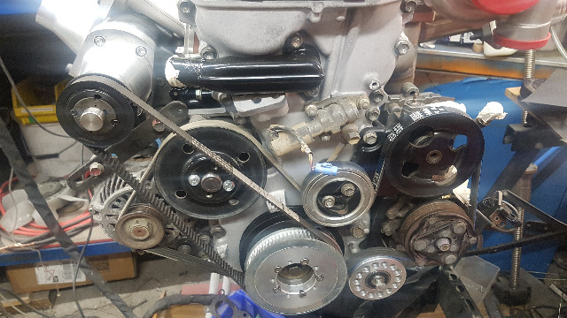

The rods in the 1.3 are oh so weak!
To have a good chance of running some decent power it gets expensive....
A 1.6 swap is the cheapest for a reasonable increase in power....timing isn't optimal but entirely bearable.
The 1.6 can't take any boost as it's CR is too high to start with.....I had a turbo on a warn out 1.3....made good power but the inevitable has to happen lol.
Have a look @ Details of the outcome
Not to be discouraged I went crazier...Turbo one side Supercharger at the other.
It's a Nike job.....No point talking about it....just do it!
