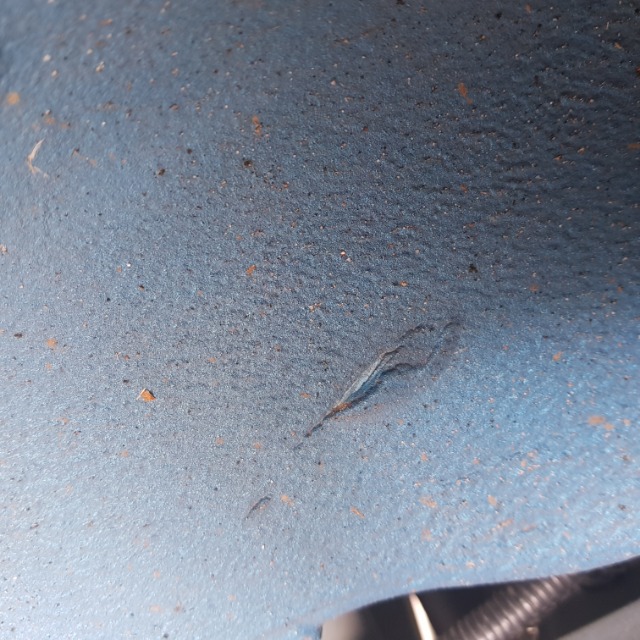

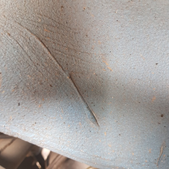

18 Aug 2019 12:11 - 18 Aug 2019 12:26 #212248 by Andy2640
Replied by Andy2640 on topic GEN 4 Jimny undersealing
Micheal wrote: I've just acquired an SZ4 and am less than impressed by the pattern of undersealing on the vehicle. Given known Suzuki rust problems on the Gen 3 Jimny and other vehicles (I had a Grand Vitara that rusted badly by year 10) would you advise undersealing? The dealer advises that Suzuki will state that having this undersealing will invalidate the 12 year corrosion warranty.
Thanks
That pricked my ears up.
In what way is the anti-corrosion pattern no good? First time ive heard someone comment on the stock anti-corrostion protection.
Ive had a good grope of the wheel arch protection, which seems a little thin. Ive also noticed some abrasions and cuts in the layer of protection (whatever it is) seems like some sort of gum. But these cuts have gone right through the layer, and expose the metal work. If rust starts there, it is effectively compromised... no?
Mhhhh, i gotta this booked in asap.
Edit: Also a bit worried about the potent odour this ditrinol treatment causes. Has anyones odour faded yet? (Giggle giggle lol).
