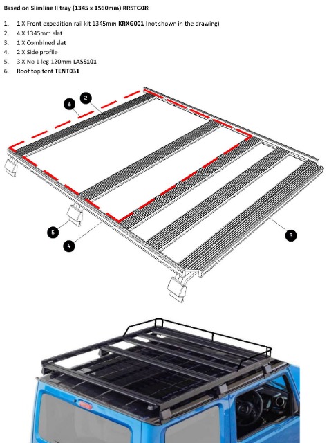

Thank you for your post Geordie, I found it very interesting since I’m looking to do something similar to my Jimny.
I’m just wondering if for a low profile and reduced weight setup, the tent can be mounted directly to two 1345mm slat add-on kit (ref RRAG1345) and leave aside the two tent’s mounting channels. Then use the lowest legs (ref LASS101) for an even lower profile.
If possible, the only downside would be that removing the tent with the load bars won’t be as easy as with the quick release mount kit, but still only 4 screws.

Ok, another idea. Since I plan to overland with the Jimny and the payload is only 340Kg, keeping the roof rack + roof tent as light and as low as possible is a must. Looking at frontrunner solutions I thought of the following rack to accommodate the tent + some additional payload.
The idea is to mount permanently the base tent to the rack slats, I think it will barely fit between side profiles, the mount would be without tent mounting channels or mounting kit. And make use use the 120mm rack legs instead of the proposed 130mm for the Jimny racks.
Of course the antenna would have to be removed and placed elsewhere.
What do you think?
What do you think?

Hi, yeah I did think about 2 120cm load bars and front runner confirmed they hold the tent and while it’s recommended to position the brackets over two slats it’s possible to mount them on one.
So the lightest and perhaps strongest 2 bar option would be front runners. I think they’d work well.
In the end I went with the 3/4 rack as it will offer more flexibility longer term. Plus I wanted to try the quick release tent brackets but I’ve changed those to the standard ones.
On The diagram you posted I’m not sure you’ll save much weight the slats are really lightweight. It’s going to be marginal. I’d recommend focusing on making it more aerodynamic as I’m seeing better results from reducing the drag and height of the tent on fuel economy and also driving experience.
People will say it’s not wise but even the full rack with the tent would work, I’m seeing plenty heavier setups online now. Text boxes for example. Still, lighter the better imho.
