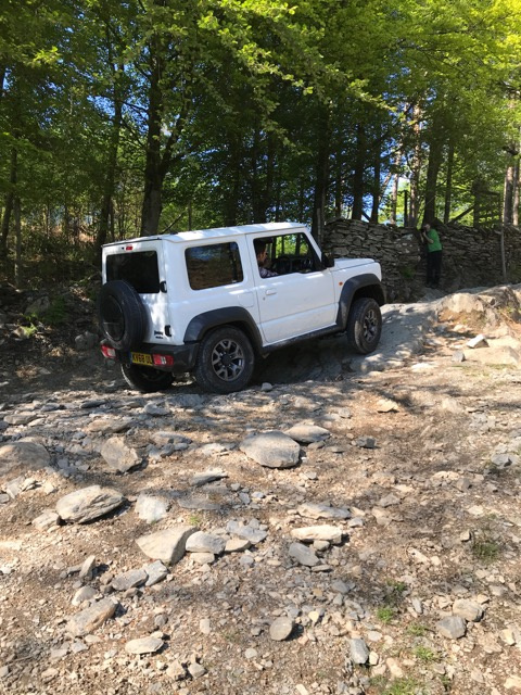

27 Jul 2019 08:45 #211520 by sniper
Replied by sniper on topic Rear lockers on gen 4 ?
From what I saw in the Lakes with a new one, it would be near perfect with the ATB..... said so at the time, the ABS thingy is very good.
