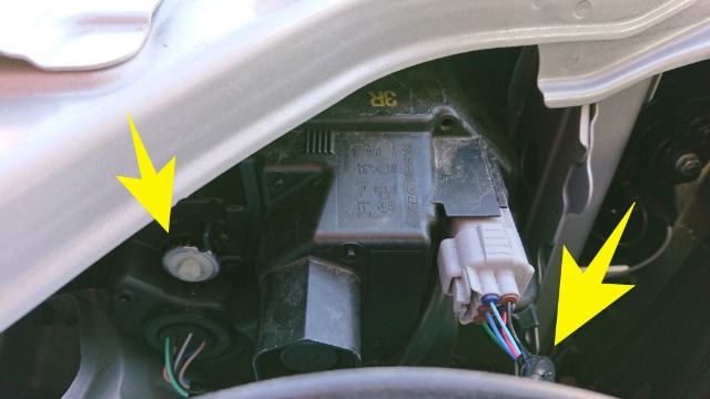

Thank you Chris. Just to double check - these are LED lights?

That's right, photo is the LED headlight. Self levelling just returns the shell to its default setting. It's this default setting that you are changing. When you start fiddling it will all make sense.

Replied by Paxijimny on topic Gen4 LED Headlight Specs
Thank you Chris very helpful - the Greek Suzuki dealer told me there was no adjustment. I'm in Greece next week-end and will find myself a wall and level ground! James

Replied by Soeley on topic Gen4 LED Headlight Specs
Thanks CC for stepping in, been busy today.
It seems a lot of dealers are telling people they are not adjustable just because they are self levelling
