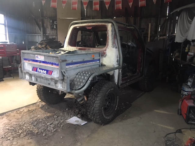

My project Jimny Ulysses has been significantly modified on the shell (below), but the chassis has merely had the rusty bits 'replaced' with a like-for-like steel and the relevant brackets welded back to that. I have made the tipper body so that it bolts on (along with the roll cage). The cage does have outriggers welded onto the chassis, but this is no issue for the MOT on my main jimny (J999MNY) which has Jbits weld on rocksliders.
Basically I have hugely altered this car and do not expect any issues when I take it for the MOT. DVLA will be informed that its now a 2 seater and thats it. Some simple recovery gear should be nothing to worry about
