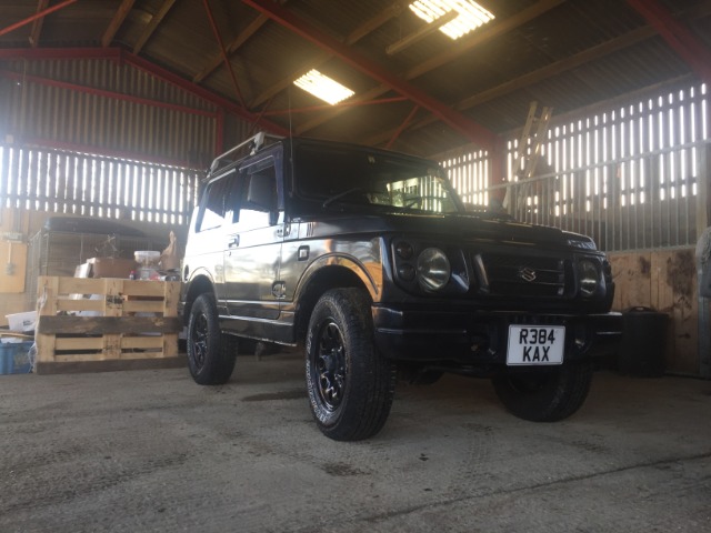

so we racked up 2500 miles in 6 weeks. having the boost controller in the cab is a dream, can wick it up and down as needed. its amazing the difference a bigger intercooler and the boost controller made. its drinking the air in, still haven't kicked in the fuel cut at full whack so the ecu is doing what the internet said and can handle the extra boost just fine.

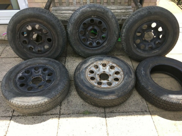

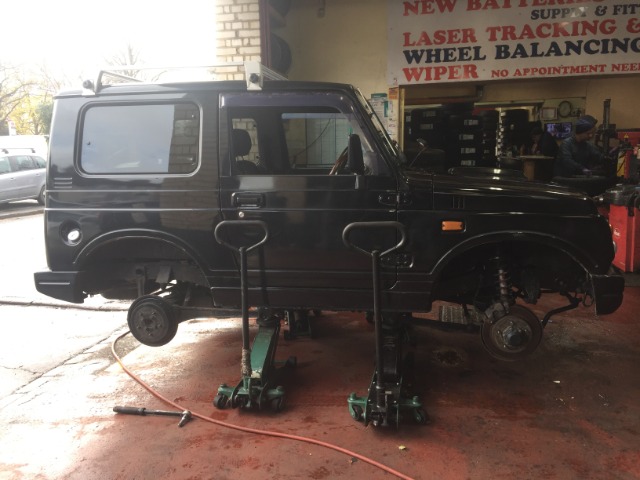

we got 5 steelies off ebay for 50quid that we got blasted coated and laquered gloss black.
goes nice with the paint, and means we can store the 16's it came on with snow tyres until we get it down to the alps one day.
managed to get some geolander a/t tyres with bonus white wall tyres from germany.

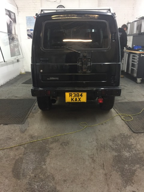

the wife wants it to be useable and look a gangster, so she had all the lenses smoked too. again, i think it looks pretty mint.
We did a bit of off roading around Yorkshire over Christmas and plowing around in 7" of snow in the dales one weekend and the tyres were great, as well as the car in general.
