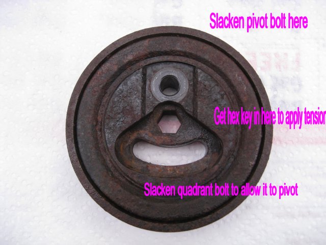

You mean this pulley?
There should be room to get one of those Irwin extractors in, or take the other bolt right out, get as much strain on it as you can, and try tapping the whole tensioner round anticlockwise to "help" it a bit, you could even try helping it with the hexagon key.
Don't tap the outside of the bearing, only the solid centre part!
