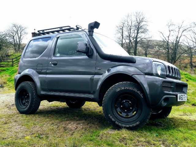

I have mine turned around towards the drivers window to get the full induction roar :laugh:
Its there because I do sometimes go through water over the bonnet. Fuel consumption is hard to tell because of the other stuff on it. The head gets caught on low branches if the correct way around (replaceable part). Mine is the long side version with JIMNY moulded into it. Stands up to abuse pretty well. Careful fitting and the template are the key.
EDIT: Forgot to say, its pointless without full diff gearbox and transfer box breather kit as well (other than for the noise

In my opinion they are only worthwhile if you drive through water deeper than the top of the tyres. There is no performance benefit. Based on my experience driving in the outback they increase the amount of dust sucked in, not reduce it (unless you fit a cyclonic separator on the top). There will be a small increase in aerodynamic drag, but I don't think it is significant. They snag on branches.
