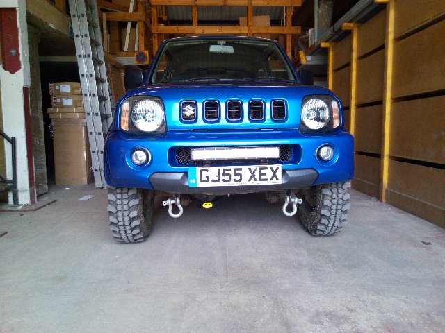

I just got a 42 inch curved version of that type of light bar. 1188 watt, It is very bright.
I'm going to enjoy blinding all the muppets coming towards me with there front fog lights on, Something that seems to be the in thing
in the UK if you don't have drl's.

Ooh , I'm going to have to steal that idea. Loving the side mount badge.

Led lights are pretty amazing, but omg trying to understand all the bull that they come bundled with..
I mean 1188 watts? So thats 99 amps right? But its not, so they cant really be that many watts.. (not having a dig at you jezz) more the way they are advertised..
Lumens are bit more meaningfull, but again we are at the mercy of whatever the chinese manufacturers say.. Ive seen torches that claim around 12,000 lumen ??? And im sure they are... lol
I still like xenons and a while back worked out that to get the same brightness from leds would also consume the same amount of power, but the led light would be larger by a long way..
Tried a led headlight bulb a while back, that was appalling and no match for the oem halogen.
Those light bars are good value for money now though, with many having spot and flood combinations in them..

THe blurb from the seller, But i do know what you mean.
Power: 1188W
Luminous Flux: approx 118800lm
Working Voltage: DC 9~32V(fits 12V,24V vehicles)
Number of Chips: 198pcs*6W high intensity LEDs
Protection Rate: IP68
Color Temperature: Cold White 6500K
Working Temperature: -40~85 degree Celsius
Beam Angle: Spot & Flood =Combo
Size(without bracket):as the pictures show
Black extruded Aluminum profile,high transmission PC lens
Alu Firm mounting bracket,150 degree adjustable
About 50,000 hours life time
Certified by CE & ROHs
