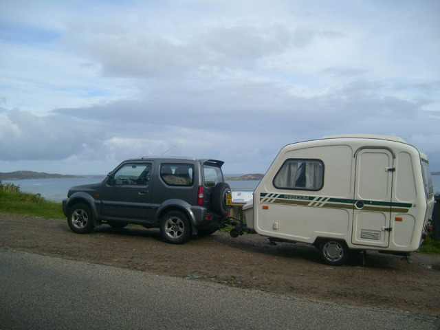

Did the same trip with a 750kg caravan. No problems.
