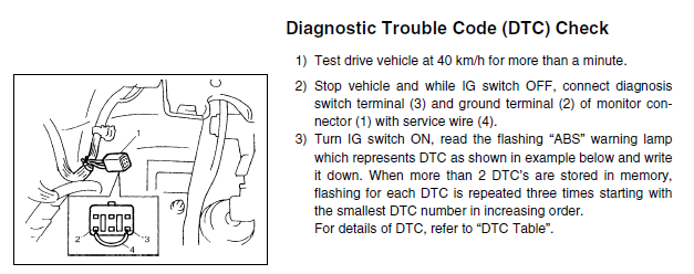

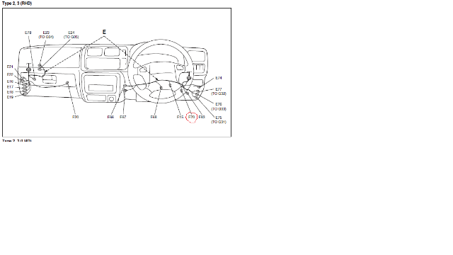

I have never had to do the code detection on an ABS Jimny but the manual describes the connector as E70-BLUE
And the diagnostic mode is achieved by linking across the terminals as shown, the ABS light then flashes a code to you

Yep the plug is against the firewall in the position shown on mlines first pic, mine was a bit more to the right, it's a right pita to get to mind!
