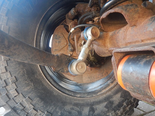

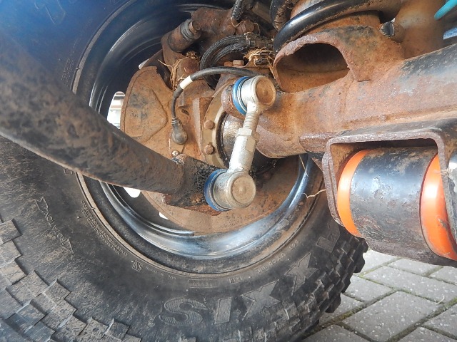

Results of fitting ARB spacers...
As predicted the droplinks have straightened out (a little, I may need some bigger spacers as I'm running 5" of lift, but you can see the positive effect of fitting these!)
Before -
After -
Chuffed B)
(I'm easily pleased :lol: )
