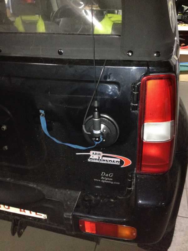

Or you could place your aerial with magnetfoot as seen on the picture below, i just did put a extra "security-strap" around it.
Offcourse when you change the position of your aerial you have to do some new SWR readings and tuning of it.
Later i did put it on top of the roof for the better result i did get on this position, even it is a soft-top Jimny.
To avoid as much as possible the aerial to get sweaped of by branches i don't tighten too hard the screw that regulates the inclination (angle) of the aerial, so if it is hit, the aerial gets flat on the roof without taking the magnetfoot off.
Until now i only had it knocked off twice on low speed because the branches did already touched the front screen so you did now what was coming up next on top of the roof...
A quick stop to put it all straight up again and off we went again.

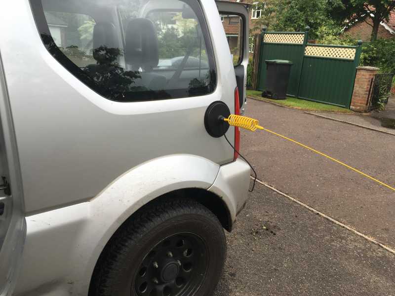

I would put the mag mount on the back door, but my mount only allows the aerial out vertical, so it would stick out about 1.5 metres behind my car! I have also already knocked it off the roof on the road, so unless I can sort my SWR problems, the mag mount will be going back to whence it came.
After moving it around the roof, trying various locations, I couldn't get the SWR low enough still. I did find that best readings came from when I was getting irritated I stuck it on the side like so: :silly:
While the SWR was then around 2 on channel 40 and about 3 on channel 1, this mounting location is not practical and the SWR is still far too high!
