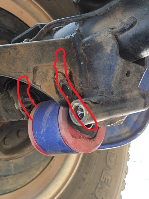

Roger Fairclough wrote: Iv'e never liked polybushes and your photos prove the point.A standard void type bush does not extend past the radius arm so the arm can twist and it's this twist that allows the suspension to work in articulation mode. Look at the photo and you will see that the flange on the polybush is stopping this flex.
I would suggest you replace the polybushes with original void bushes and then you will see full articulation.
Roger
Dave used to tell me off for saying poly bushes don't flex, and indeed his super Jimny clad with 900kg of accessories did flex very well, but i agree with you. The standard bushes are thoughtfully designed. Poly bushes and castor correction bushes both seem to bind up and limit flex.

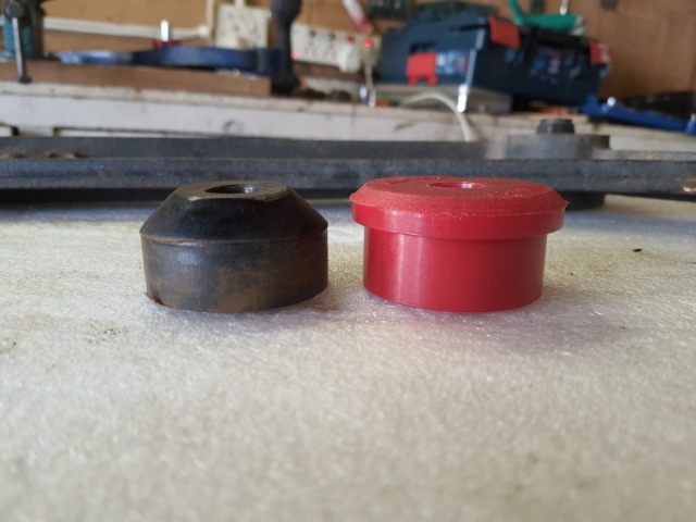

Stock rubber bushes are very good and flex well, they however do start getting very stressed when flexing on the extreme side. It will wear them out quicker and start tearing. They are also much better resistance to sand / mud as they are sealed unit. I have often removed my various polly bushes to find sand & gunk inside them not ideal at all.
I do tend to agree with @rogders comment about how the polly bushes fill up the entire gap and prevent the radial arm from rotating. I have been through a few sets of polly bushes. I currently have the softest most squishy bushes I can find. And they do flex very well.
Old on the left and new on the right (red)
Old was a solid poly compound way to hard in my opinion, however its shape wouldn't resist rotating as much. The red bush is a hollow honey comb structure and much softer, however its quite square on the outside.

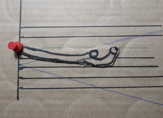

So I went old-school and got out some cardboard and drew up this small 2D simulation of the suspension:
What this demonstrated to me was why the rear polly bush wanted to pull down. The two blue lines are the diff angels when fully compressed vs fully drooped. Top one is compressed (so Right hand side radial arm in my test) and the bottom line is the LHS radial arm. This explains the binding to me perfectly, because 4 bushes simply cannot counter such a big angle is difference. (this is what got me onto a 4 link idea, ad the axel line will stay level throughout the compression stage?
What I am stugaaling to understand is this TWIST in the radail arm that you speak of. From my very limited suspension theory, and my simple 2d drawing. this issue is actually not that the diff wants to move, but as the radail arm drops it goes through its radail and the bottom bush starts dropping, the more you want to droop, the greater that angle?
In my head and from my little cardboard drawing a 3/4 link is the only setup that will not cause that vertical binding. (this is in the theoretical word) Again I'm not saying all the effort,cost & complexity would be worth those extra few inches of travel.
