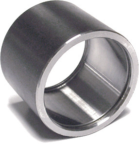

3 simple components
Side cups are polyurethane and hole joint can be greased
12 Nov 2013 17:50 #90622 by kirkynut
Replied by kirkynut on topic Adjustable Panhard rods
Ah right, like Simon uses in his X Arms on those pesky Landrovers! I make you right! If they can take the responsibility of locating half a Landrover axle they'll do a good job on a Zukes panhard rod.
  • Dave cc
12 Nov 2013 18:13 #90629 by Dave cc
Replied by Dave cc on topic Adjustable Panhard rods
kirkynut wrote: Ah right, like Simon uses in his X Arms on those pesky Landrovers! I make you right! If they can take the responsibility of locating half a Landrover axle they'll do a good job on a Zukes panhard rod.
Kinda i guess :unsure:
these have loads of uses on Zukes if packaged in the correct housings/rod/arms just need get some interest and kick the ruddy Anti,s into touch :P
