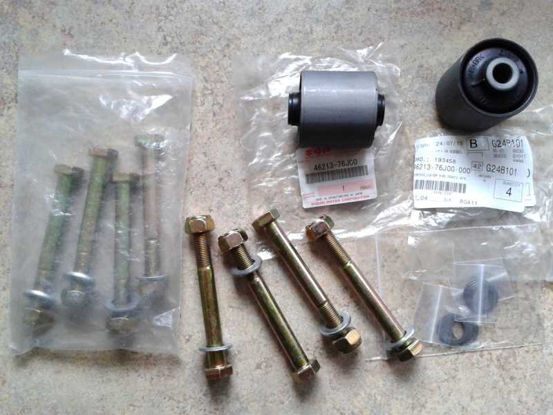

If you get Death Wobble once you have fitted this, and I'm not saying that you will, try replacing the front panhard rod bushes with the ones sold on the Big Jimny Shop.
I found the SuperPro ones too soft and they caused movement in the panhard rod and thus Death Wobble. You might be OK as others are.
Replied by kirkynut on topic What did the postman bring today

Thanks for that bit of info Kirky as my death wobble got slightly worse after changing from knackered rose jointed pan hards to the jimnybits ones with superpro bushes. I'll have to look for some harder bushings.
