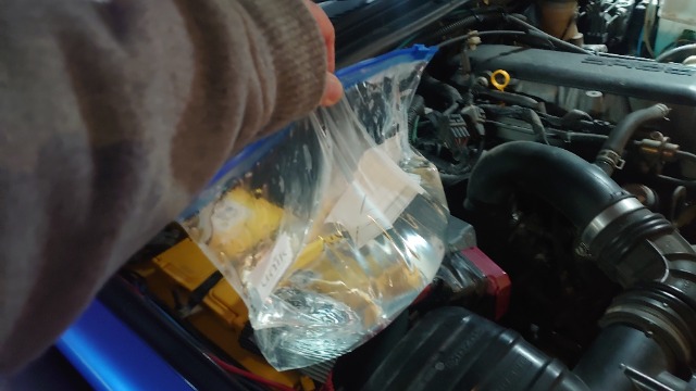

Holding a bag of warn water up against possibly frozen componenents to fault find my 4x4. It only works above freezing. After Holding the bag at the solenoids it came back.
Replied by yakuza on topic What did you do to your jimny today
