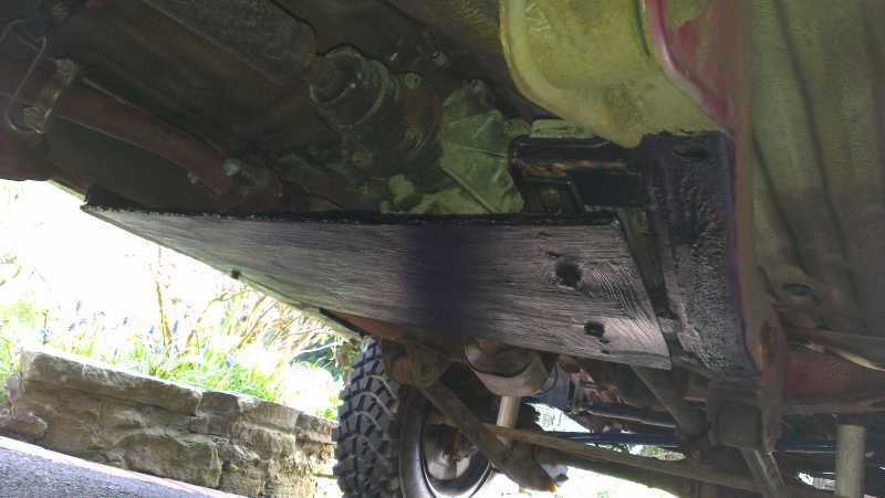

01 May 2013 18:30 #69818
by GWR
Replied by GWR on topic Re: What did you do to your jimny today
- gaz3359
01 May 2013 18:42 #69820
by gaz3359
Replied by gaz3359 on topic What did you do to your jimny today
doesnt have to be pretty will do the job nicely i reccon.
- Dan_w
01 May 2013 21:50 #69845
by Dan_w
Replied by Dan_w on topic Re: What did you do to your jimny today
Looks like it will do a great job
