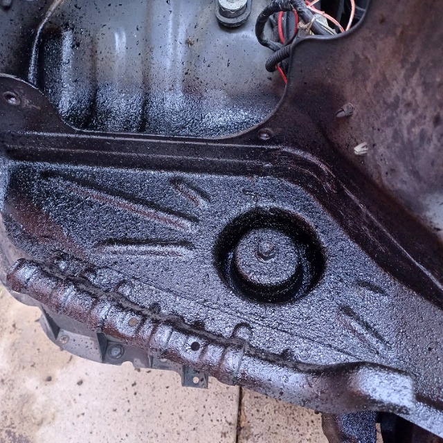

Removed the rear seats
The floor showed some starting rust issues, so I fixed that.
Luckily it was only rusted through on 1 small spot, so I welded in a small patch
Treated all the other rust with Bilt Hamber Hydrate 80, which supposedly both converts the rust and seals it off
Then some rattle-can paint to finish it all up

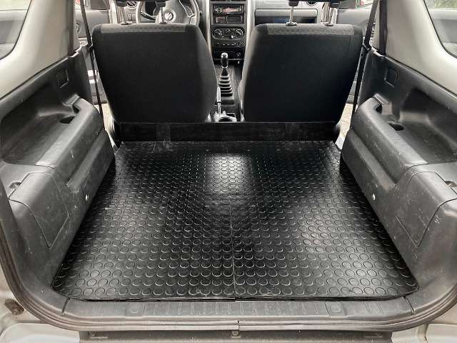

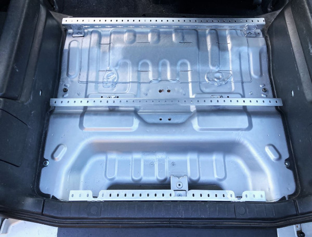

I fabbed some frontrunner-style rails for floorboard to go on.
All bolted to existing mounting points
Floorboard is next...
