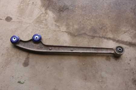

Paul if this is the radius arms that just acquired.
Before you fit them you will need to refit the bushes as in the photo below.
