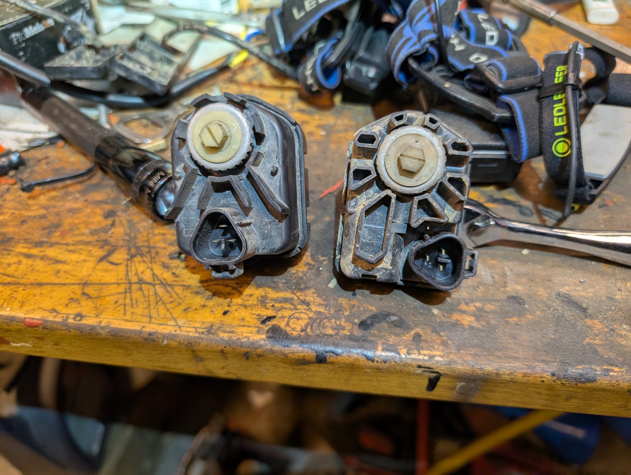

Pics from after I swapped my headlights and the actuators did not work. I was sure that the adjuster in the dash made them go the wrong way with the 99 ones in my 05 car, but they had little movement so Could be broken too.
They look a bit different though.
Link to a video on this.
Can be changed without taking the lights out too.
There is a plastic piece behind the actuators you can manipulate to make them Come out easier.
